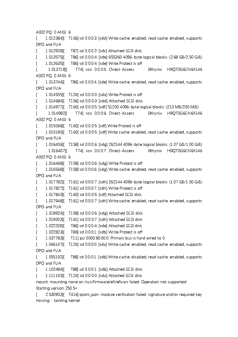

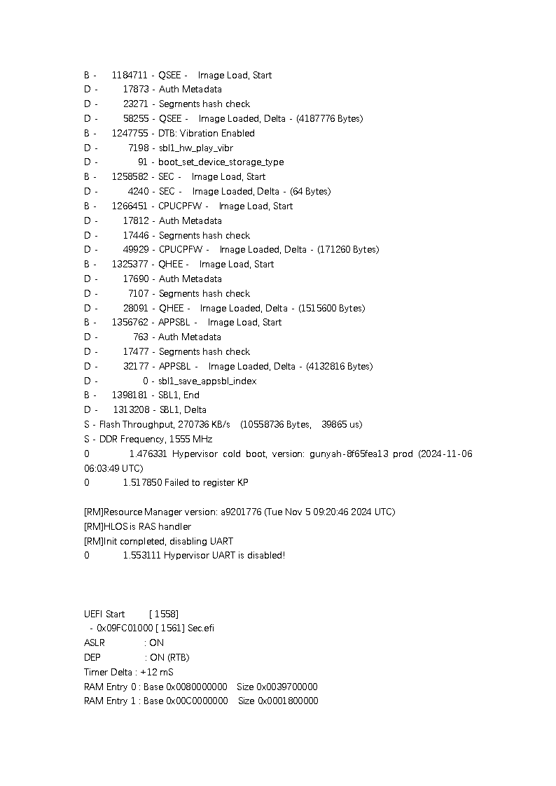

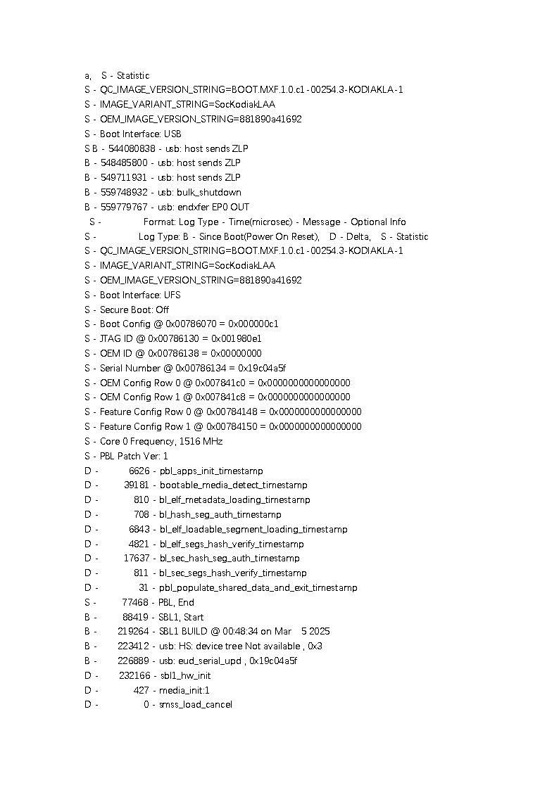

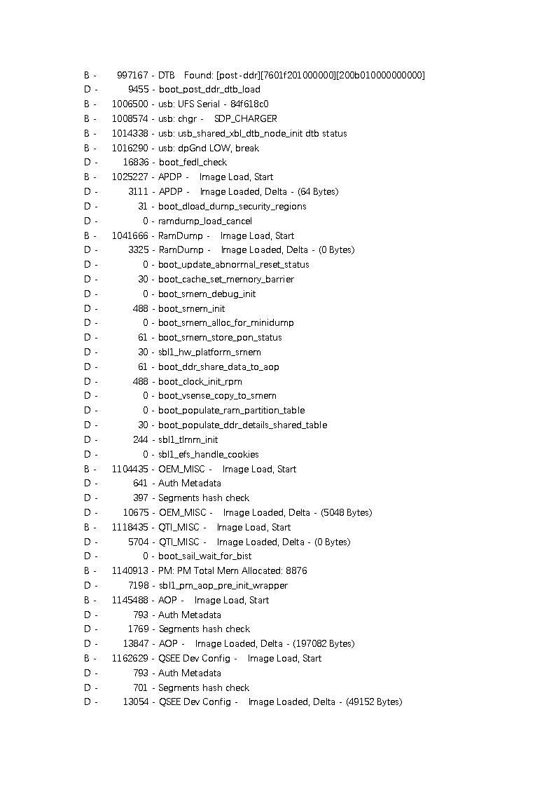

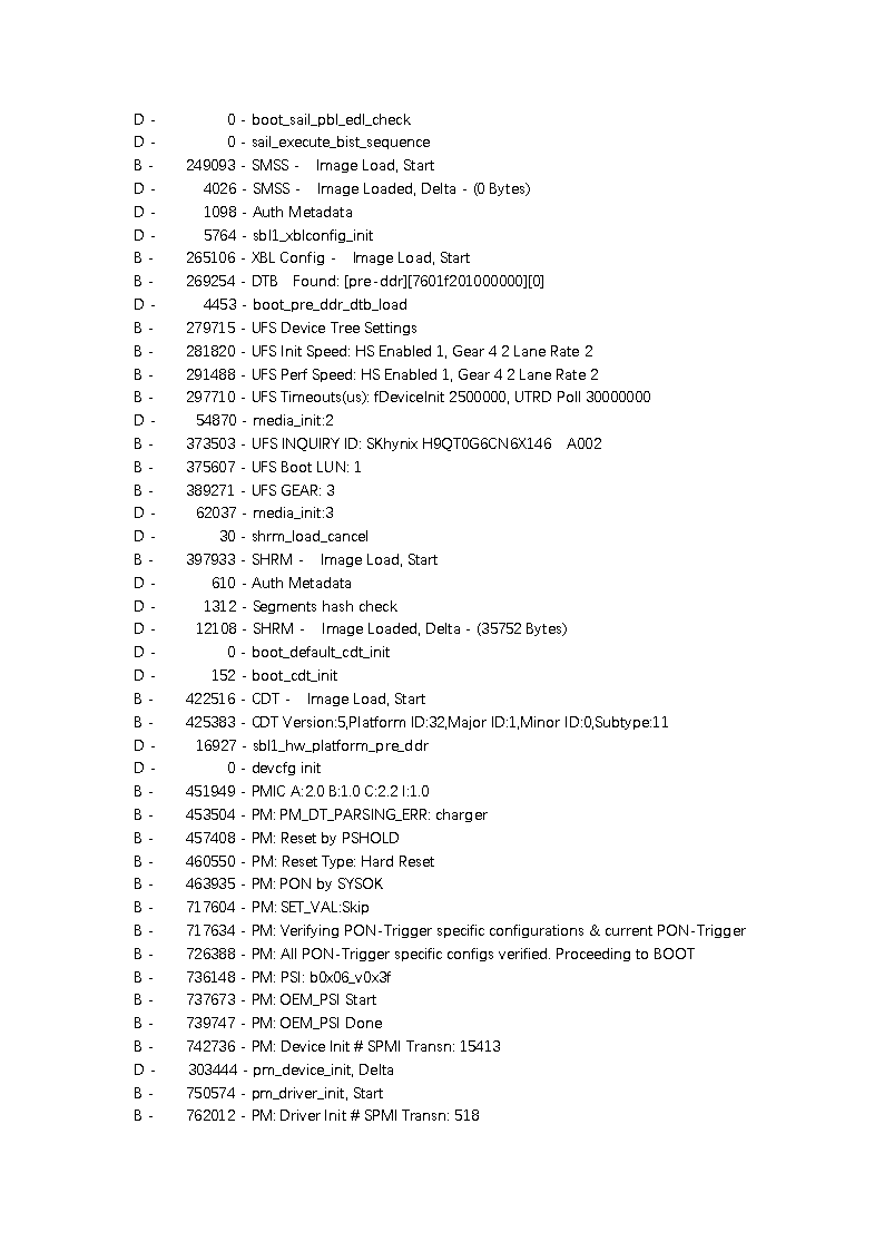

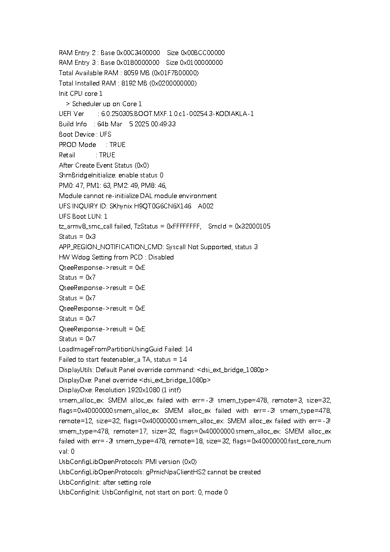

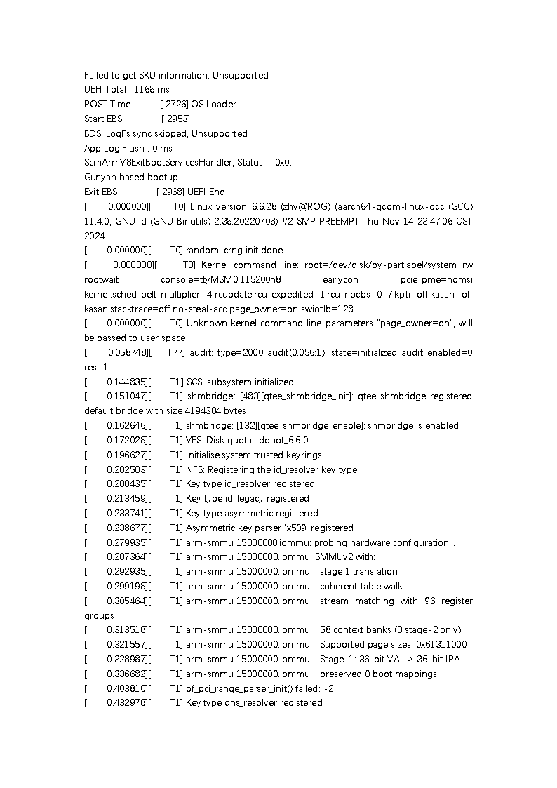

Windows 下使用Tflash 升级魔方派3 Linux 镜像 V1.1 ,能正常开机,但是使用官网里的linux version(v6.28-fc1), 编译后,把dtb.bin以及efi.bin 替换镜像里,重新烧录,开机卡住起不来,是什么原因?
请问客户有做修改吗
请上传一份开机异常的log

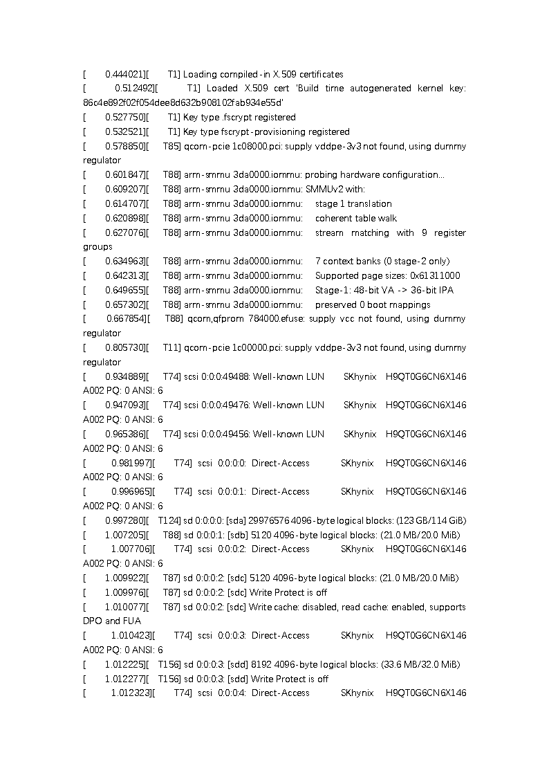

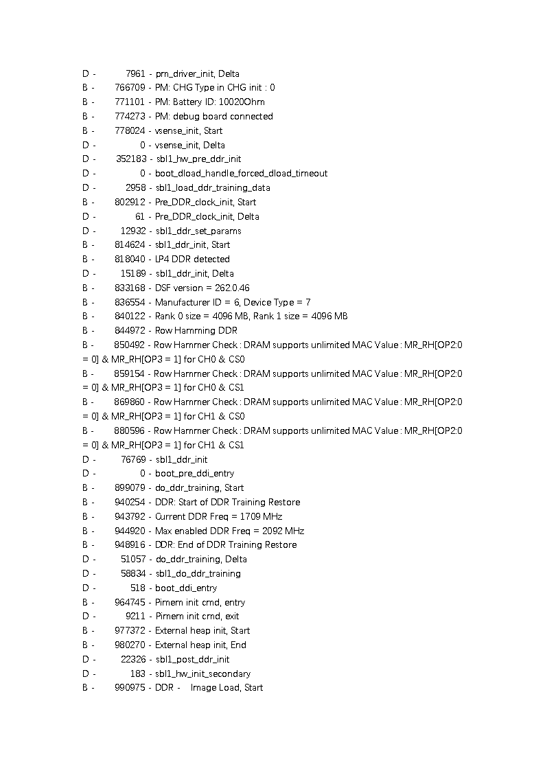

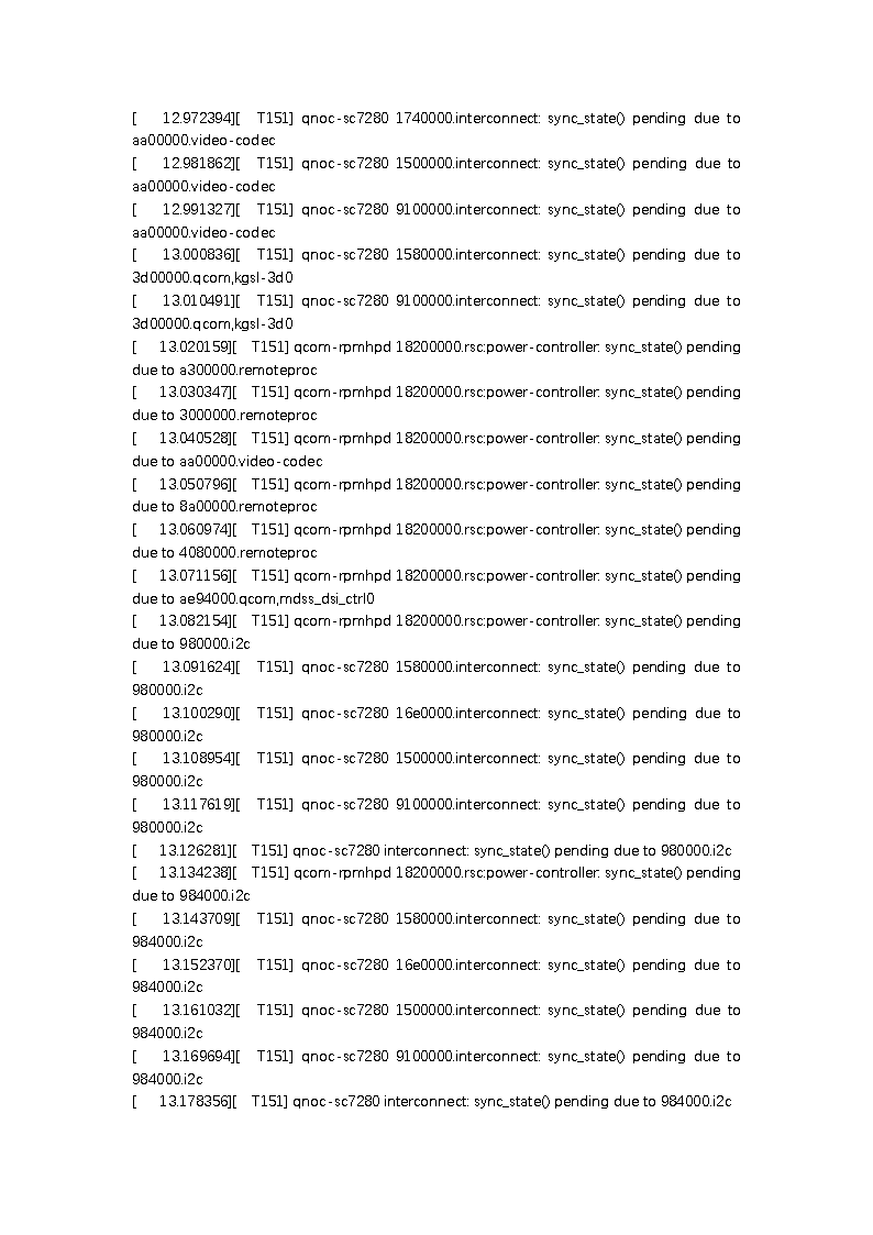

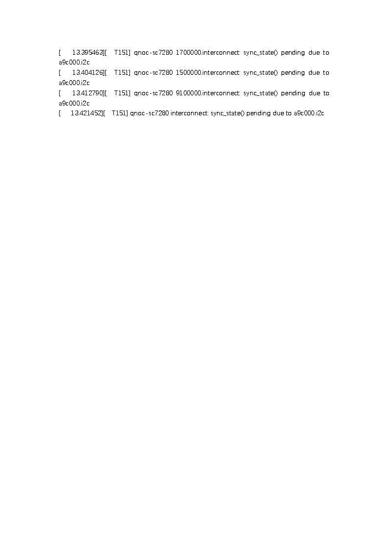

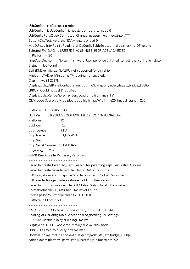

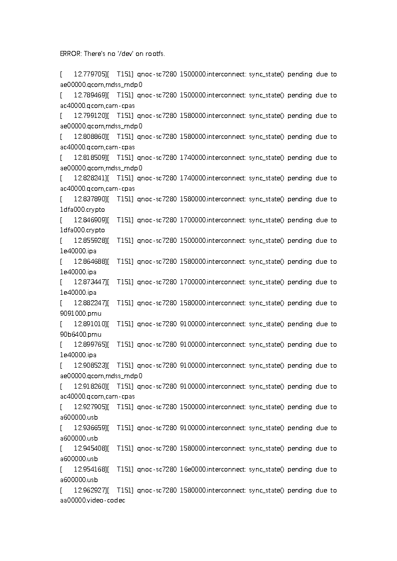

没做修改,直接 git clone 下来后编译替换文档,然后使用Tflash download
这是接着的四张图,时间轴按需要排列
为了开发人员更方便地查看log,可否请客户直接将log复制粘贴到楼层
不支持文档上传,只能转成图片
a, S - Statistic
S - QC_IMAGE_VERSION_STRING=BOOT.MXF.1.0.c1-00254.3-KODIAKLA-1
S - IMAGE_VARIANT_STRING=SocKodiakLAA
S - OEM_IMAGE_VERSION_STRING=881890a41692
S - Boot Interface: USB
S B - 544080838 - usb: host sends ZLP
B - 548485800 - usb: host sends ZLP
B - 549711931 - usb: host sends ZLP
B - 559748932 - usb: bulk_shutdown
B - 559779767 - usb: endxfer EP0 OUT
S - Format: Log Type - Time(microsec) - Message - Optional Info
S - Log Type: B - Since Boot(Power On Reset), D - Delta, S - Statistic
S - Boot Interface: UFS
S - Secure Boot: Off
S - Boot Config @ 0x00786070 = 0x000000c1
S - JTAG ID @ 0x00786130 = 0x001980e1
S - OEM ID @ 0x00786138 = 0x00000000
S - Serial Number @ 0x00786134 = 0x19c04a5f
S - OEM Config Row 0 @ 0x007841c0 = 0x0000000000000000
S - OEM Config Row 1 @ 0x007841c8 = 0x0000000000000000
S - Feature Config Row 0 @ 0x00784148 = 0x0000000000000000
S - Feature Config Row 1 @ 0x00784150 = 0x0000000000000000
S - Core 0 Frequency, 1516 MHz
S - PBL Patch Ver: 1
D - 6626 - pbl_apps_init_timestamp
D - 39181 - bootable_media_detect_timestamp
D - 810 - bl_elf_metadata_loading_timestamp
D - 708 - bl_hash_seg_auth_timestamp
D - 6843 - bl_elf_loadable_segment_loading_timestamp
D - 4821 - bl_elf_segs_hash_verify_timestamp
D - 17637 - bl_sec_hash_seg_auth_timestamp
D - 811 - bl_sec_segs_hash_verify_timestamp
D - 31 - pbl_populate_shared_data_and_exit_timestamp
S - 77468 - PBL, End
B - 88419 - SBL1, Start
B - 219264 - SBL1 BUILD @ 00:48:34 on Mar 5 2025
B - 223412 - usb: HS: device tree Not available , 0x3
B - 226889 - usb: eud_serial_upd , 0x19c04a5f
D - 232166 - sbl1_hw_init
D - 427 - media_init:1
D - 0 - smss_load_cancel
D - 0 - boot_sail_pbl_edl_check
D - 0 - sail_execute_bist_sequence
B - 249093 - SMSS - Image Load, Start
D - 4026 - SMSS - Image Loaded, Delta - (0 Bytes)
D - 1098 - Auth Metadata
D - 5764 - sbl1_xblconfig_init
B - 265106 - XBL Config - Image Load, Start
B - 269254 - DTB Found: [pre-ddr][7601f201000000][0]
D - 4453 - boot_pre_ddr_dtb_load
B - 279715 - UFS Device Tree Settings
B - 281820 - UFS Init Speed: HS Enabled 1, Gear 4 2 Lane Rate 2
B - 291488 - UFS Perf Speed: HS Enabled 1, Gear 4 2 Lane Rate 2
B - 297710 - UFS Timeouts(us): fDeviceInit 2500000, UTRD Poll 30000000
D - 54870 - media_init:2
B - 373503 - UFS INQUIRY ID: SKhynix H9QT0G6CN6X146 A002
B - 375607 - UFS Boot LUN: 1
B - 389271 - UFS GEAR: 3
D - 62037 - media_init:3
D - 30 - shrm_load_cancel
B - 397933 - SHRM - Image Load, Start
D - 610 - Auth Metadata
D - 1312 - Segments hash check
D - 12108 - SHRM - Image Loaded, Delta - (35752 Bytes)
D - 0 - boot_default_cdt_init
D - 152 - boot_cdt_init
B - 422516 - CDT - Image Load, Start
B - 425383 - CDT Version:5,Platform ID:32,Major ID:1,Minor ID:0,Subtype:11
D - 16927 - sbl1_hw_platform_pre_ddr
D - 0 - devcfg init
B - 451949 - PMIC A:2.0 B:1.0 C:2.2 I:1.0
B - 453504 - PM: PM_DT_PARSING_ERR: charger
B - 457408 - PM: Reset by PSHOLD
B - 460550 - PM: Reset Type: Hard Reset
B - 463935 - PM: PON by SYSOK
B - 717604 - PM: SET_VAL:Skip
B - 717634 - PM: Verifying PON-Trigger specific configurations & current PON-Trigger
B - 726388 - PM: All PON-Trigger specific configs verified. Proceeding to BOOT
B - 736148 - PM: PSI: b0x06_v0x3f
B - 737673 - PM: OEM_PSI Start
B - 739747 - PM: OEM_PSI Done
B - 742736 - PM: Device Init # SPMI Transn: 15413
D - 303444 - pm_device_init, Delta
B - 750574 - pm_driver_init, Start
B - 762012 - PM: Driver Init # SPMI Transn: 518
D - 7961 - pm_driver_init, Delta

B - 997167 - DTB Found: [post-ddr][7601f201000000][200b010000000000]
D - 9455 - boot_post_ddr_dtb_load
B - 1006500 - usb: UFS Serial - 84f618c0
B - 1008574 - usb: chgr - SDP_CHARGER
B - 1014338 - usb: usb_shared_xbl_dtb_node_init dtb status
B - 1016290 - usb: dpGnd LOW, break
D - 16836 - boot_fedl_check
B - 1025227 - APDP - Image Load, Start
D - 3111 - APDP - Image Loaded, Delta - (64 Bytes)
D - 31 - boot_dload_dump_security_regions
D - 0 - ramdump_load_cancel
B - 1041666 - RamDump - Image Load, Start
D - 3325 - RamDump - Image Loaded, Delta - (0 Bytes)
D - 0 - boot_update_abnormal_reset_status
D - 30 - boot_cache_set_memory_barrier
D - 0 - boot_smem_debug_init
D - 488 - boot_smem_init
D - 0 - boot_smem_alloc_for_minidump
D - 61 - boot_smem_store_pon_status
D - 30 - sbl1_hw_platform_smem
D - 61 - boot_ddr_share_data_to_aop
D - 488 - boot_clock_init_rpm
D - 0 - boot_vsense_copy_to_smem
D - 0 - boot_populate_ram_partition_table
D - 30 - boot_populate_ddr_details_shared_table
D - 244 - sbl1_tlmm_init
D - 0 - sbl1_efs_handle_cookies
B - 1104435 - OEM_MISC - Image Load, Start
D - 641 - Auth Metadata
D - 397 - Segments hash check
D - 10675 - OEM_MISC - Image Loaded, Delta - (5048 Bytes)
B - 1118435 - QTI_MISC - Image Load, Start
D - 5704 - QTI_MISC - Image Loaded, Delta - (0 Bytes)
D - 0 - boot_sail_wait_for_bist
B - 1140913 - PM: PM Total Mem Allocated: 8876
D - 7198 - sbl1_pm_aop_pre_init_wrapper
B - 1145488 - AOP - Image Load, Start
D - 793 - Auth Metadata
D - 1769 - Segments hash check
D - 13847 - AOP - Image Loaded, Delta - (197082 Bytes)
B - 1162629 - QSEE Dev Config - Image Load, Start
D - 701 - Segments hash check
D - 13054 - QSEE Dev Config - Image Loaded, Delta - (49152 Bytes)

B - 1398181 - SBL1, End
D - 1313208 - SBL1, Delta
S - Flash Throughput, 270736 KB/s (10558736 Bytes, 39865 us)
S - DDR Frequency, 1555 MHz
0 1.476331 Hypervisor cold boot, version: gunyah-8f65fea13 prod (2024-11-06 06:03:49 UTC)
0 1.517850 Failed to register KP
[RM]Resource Manager version: a9201776 (Tue Nov 5 09:20:46 2024 UTC)
[RM]HLOS is RAS handler
[RM]Init completed, disabling UART
0 1.553111 Hypervisor UART is disabled!
UEFI Start [ 1558]
  • 0x09FC01000 [ 1561] Sec.efi
    ASLR : ON
    DEP : ON (RTB)
    Timer Delta : +12 mS
    RAM Entry 0 : Base 0x0080000000 Size 0x0039700000
    RAM Entry 1 : Base 0x00C0000000 Size 0x0001800000
    RAM Entry 2 : Base 0x00C3400000 Size 0x00BCC00000
    RAM Entry 3 : Base 0x0180000000 Size 0x0100000000
    Total Available RAM : 8059 MB (0x01F7B00000)
    Total Installed RAM : 8192 MB (0x0200000000)
    Init CPU core 1
Scheduler up on Core 1
UEFI Ver : 6.0.250305.BOOT.MXF.1.0.c1-00254.3-KODIAKLA-1
Build Info : 64b Mar 5 2025 00:49:33
Boot Device : UFS
PROD Mode : TRUE
Retail : TRUE
After Create Event Status (0x0)
ShmBridgeInitialize: enable status 0
PM0: 47, PM1: 63, PM2: 49, PM8: 46,
Module cannot re-initialize DAL module environment
UFS Boot LUN: 1
tz_armv8_smc_call failed, TzStatus = 0xFFFFFFFF, SmcId = 0x32000105
Status = 0x3
APP_REGION_NOTIFICATION_CMD: Syscall Not Supported, status 3
HW Wdog Setting from PCD : Disabled
QseeResponse->result = 0xE
Status = 0x7
Status = 0x7
Status = 0x7
Status = 0x7
LoadImageFromPartitionUsingGuid Failed: 14
Failed to start featenabler_a TA, status = 14
DisplayUtils: Default Panel override command: <dsi_ext_bridge_1080p>
DisplayDxe: Panel override <dsi_ext_bridge_1080p>
DisplayDxe: Resolution 1920x1080 (1 intf)
smem_alloc_ex: SMEM alloc_ex failed with err=-3! smem_type=478, remote=3, size=32, flags=0x40000000.smem_alloc_ex: SMEM alloc_ex failed with err=-3! smem_type=478, remote=12, size=32, flags=0x40000000.smem_alloc_ex: SMEM alloc_ex failed with err=-3! smem_type=478, remote=17, size=32, flags=0x40000000.smem_alloc_ex: SMEM alloc_ex failed with err=-3! smem_type=478, remote=18, size=32, flags=0x40000000.fast_core_num val: 0
UsbConfigLibOpenProtocols: PMI version (0x0)
UsbConfigLibOpenProtocols: gPmicNpaClientHS2 cannot be created
UsbConfigInit: after setting role
UsbConfigInit: UsbConfigInit, not start on port: 0, mode 0
UsbConfigInit: UsbConfigInit, not start on port: 1, mode 0
UsbConfigPortsQueryConnectionChange: usbport->connectstate: ATT
ButtonsDxeTest: Keypress SDAM data payload 0
HypDtFixupEntryPoint : Reading of OsConfigTableSelection failed,checking DT setting
Selected FW GUID =: 6F25BFD2-A165-468B-980F-AC51A0A45C52
Platform = 20
FmpDxe(Qualcomm System Firmware Update Driver): Failed to get the controller state. Status = Not Found
SoftSKUDxeInitialize: SoftSKU not supported for this chip
MinidumpTADxe: Minidump TA loading not enabled.
Disp init wait [ 2237]
Display_Utils_SetPanelConfiguration: pConfigStr= qcom,mdss_dsi_ext_bridge_1080p:
ERROR: Could not get DtbBuffer.
Display_Utils_RenderSplashScreen: Load bmp from main FV
OEM Logo Successfully Loaded: Logo file ImageWidth = 620: ImageHeight = 200
Platform Init [ 2305] BDS
Platform : IOT
Subtype : 11
Boot Device : UFS
Chip Name : QCS6490
Chip Ver : 1.0
Chip Serial Number : 0x19C04A5F
ufs_error_log: 252
RPMB ReadCounterPkt failed, Result = 6
Failed to create ‘Persisted_Capsules.bin’ for persisting capsules. Status: Success
Failed to create capsule raw file. Status: Out of Resources
InitStoragePointersForCapsuleRawFile returned - Out of Resources!
InitCapsuleStoragePointers returned - Out of Resources.
Failed to flush capsule raw file GUID table. Status: Invalid Parameter
LocateProtocol(DPP) returned Status:Not Found
Locate pMorPpiProtocol failed 0xE 00000010
Platform Init End : 2503
OS DTB found. Model = Thundercomm, Inc. Rubik Pi C6490P
Reading of OsConfigTableSelection failed,checking DT settings
ERROR: DisableDisplay disabling,Status=0
DisplayDxe: NULL Handle for Primary display NPA node.
ERROR: Fail to turn display off,Status=7
UpdateDisplayCmdLine : pNewStr = qcom,mdss_dsi_ext_bridge_1080p
Added qcom,platform-parts-info successfully in BoardInfoDxe
Failed to get SKU information. Unsupported
UEFI Total : 1168 ms
POST Time [ 2726] OS Loader
Start EBS [ 2953]
BDS: LogFs sync skipped, Unsupported
App Log Flush : 0 ms
ScmArmV8ExitBootServicesHandler, Status = 0x0.
Gunyah based bootup
Exit EBS [ 2968] UEFI End
[ 0.000000][ T0] Linux version 6.6.28 (zhy@ROG) (aarch64-qcom-linux-gcc (GCC) 11.4.0, GNU ld (GNU Binutils) 2.38.20220708) #2 SMP PREEMPT Thu Nov 14 23:47:06 CST 2024
[ 0.000000][ T0] random: crng init done
[ 0.000000][ T0] Kernel command line: root=/dev/disk/by-partlabel/system rw rootwait console=ttyMSM0,115200n8 earlycon pcie_pme=nomsi kernel.sched_pelt_multiplier=4 rcupdate.rcu_expedited=1 rcu_nocbs=0-7 kpti=off kasan=off kasan.stacktrace=off no-steal-acc page_owner=on swiotlb=128
[ 0.000000][ T0] Unknown kernel command line parameters “page_owner=on”, will be passed to user space.
[ 0.058748][ T77] audit: type=2000 audit(0.056:1): state=initialized audit_enabled=0 res=1
[ 0.144835][ T1] SCSI subsystem initialized
[ 0.151047][ T1] shmbridge: [483][qtee_shmbridge_init]: qtee shmbridge registered default bridge with size 4194304 bytes
[ 0.162646][ T1] shmbridge: [132][qtee_shmbridge_enable]: shmbridge is enabled
[ 0.172028][ T1] VFS: Disk quotas dquot_6.6.0
[ 0.196627][ T1] Initialise system trusted keyrings
[ 0.202503][ T1] NFS: Registering the id_resolver key type
[ 0.208435][ T1] Key type id_resolver registered
[ 0.213459][ T1] Key type id_legacy registered
[ 0.233741][ T1] Key type asymmetric registered
[ 0.238677][ T1] Asymmetric key parser ‘x509’ registered
[ 0.279935][ T1] arm-smmu 15000000.iommu: probing hardware configuration…
[ 0.287364][ T1] arm-smmu 15000000.iommu: SMMUv2 with:
[ 0.292935][ T1] arm-smmu 15000000.iommu: stage 1 translation
[ 0.299198][ T1] arm-smmu 15000000.iommu: coherent table walk
[ 0.305464][ T1] arm-smmu 15000000.iommu: stream matching with 96 register groups
[ 0.313518][ T1] arm-smmu 15000000.iommu: 58 context banks (0 stage-2 only)
[ 0.321557][ T1] arm-smmu 15000000.iommu: Supported page sizes: 0x61311000
[ 0.328987][ T1] arm-smmu 15000000.iommu: Stage-1: 36-bit VA → 36-bit IPA
[ 0.336682][ T1] arm-smmu 15000000.iommu: preserved 0 boot mappings
[ 0.403810][ T1] of_pci_range_parser_init() failed: -2
[ 0.432978][ T1] Key type dns_resolver registered
[ 0.444021][ T1] Loading compiled-in X.509 certificates
[ 0.512492][ T1] Loaded X.509 cert ‘Build time autogenerated kernel key: 86c4e892f02f054dee8d632b908102fab934e55d’
[ 0.527750][ T1] Key type .fscrypt registered
[ 0.532521][ T1] Key type fscrypt-provisioning registered
[ 0.578850][ T85] qcom-pcie 1c08000.pci: supply vddpe-3v3 not found, using dummy regulator
[ 0.601847][ T88] arm-smmu 3da0000.iommu: probing hardware configuration…
[ 0.609207][ T88] arm-smmu 3da0000.iommu: SMMUv2 with:
[ 0.614707][ T88] arm-smmu 3da0000.iommu: stage 1 translation
[ 0.620898][ T88] arm-smmu 3da0000.iommu: coherent table walk
[ 0.627076][ T88] arm-smmu 3da0000.iommu: stream matching with 9 register groups
[ 0.634963][ T88] arm-smmu 3da0000.iommu: 7 context banks (0 stage-2 only)
[ 0.642313][ T88] arm-smmu 3da0000.iommu: Supported page sizes: 0x61311000
[ 0.649655][ T88] arm-smmu 3da0000.iommu: Stage-1: 48-bit VA → 36-bit IPA
[ 0.657302][ T88] arm-smmu 3da0000.iommu: preserved 0 boot mappings
[ 0.667854][ T88] qcom,qfprom 784000.efuse: supply vcc not found, using dummy regulator
[ 0.805730][ T11] qcom-pcie 1c00000.pci: supply vddpe-3v3 not found, using dummy regulator
[ 0.934889][ T74] scsi 0:0:0:49488: Well-known LUN SKhynix H9QT0G6CN6X146 A002 PQ: 0 ANSI: 6
[ 0.947093][ T74] scsi 0:0:0:49476: Well-known LUN SKhynix H9QT0G6CN6X146 A002 PQ: 0 ANSI: 6
[ 0.965386][ T74] scsi 0:0:0:49456: Well-known LUN SKhynix H9QT0G6CN6X146 A002 PQ: 0 ANSI: 6
[ 0.981997][ T74] scsi 0:0:0:0: Direct-Access SKhynix H9QT0G6CN6X146 A002 PQ: 0 ANSI: 6
[ 0.996965][ T74] scsi 0:0:0:1: Direct-Access SKhynix H9QT0G6CN6X146 A002 PQ: 0 ANSI: 6
[ 0.997280][ T124] sd 0:0:0:0: [sda] 29976576 4096-byte logical blocks: (123 GB/114 GiB)
[ 1.007205][ T88] sd 0:0:0:1: [sdb] 5120 4096-byte logical blocks: (21.0 MB/20.0 MiB)
[ 1.007706][ T74] scsi 0:0:0:2: Direct-Access SKhynix H9QT0G6CN6X146 A002 PQ: 0 ANSI: 6
[ 1.009922][ T87] sd 0:0:0:2: [sdc] 5120 4096-byte logical blocks: (21.0 MB/20.0 MiB)
[ 1.009976][ T87] sd 0:0:0:2: [sdc] Write Protect is off
[ 1.010077][ T87] sd 0:0:0:2: [sdc] Write cache: disabled, read cache: enabled, supports DPO and FUA
[ 1.010423][ T74] scsi 0:0:0:3: Direct-Access SKhynix H9QT0G6CN6X146 A002 PQ: 0 ANSI: 6
[ 1.012225][ T156] sd 0:0:0:3: [sdd] 8192 4096-byte logical blocks: (33.6 MB/32.0 MiB)
[ 1.012277][ T156] sd 0:0:0:3: [sdd] Write Protect is off
[ 1.012323][ T74] scsi 0:0:0:4: Direct-Access SKhynix H9QT0G6CN6X146 A002 PQ: 0 ANSI: 6
[ 1.012384][ T156] sd 0:0:0:3: [sdd] Write cache: enabled, read cache: enabled, supports DPO and FUA
[ 1.012928][ T87] sd 0:0:0:2: [sdc] Attached SCSI disk
[ 1.013575][ T86] sd 0:0:0:4: [sde] 655360 4096-byte logical blocks: (2.68 GB/2.50 GiB)
[ 1.013635][ T86] sd 0:0:0:4: [sde] Write Protect is off
[ 1.013718][ T74] scsi 0:0:0:5: Direct-Access SKhynix H9QT0G6CN6X146 A002 PQ: 0 ANSI: 6
[ 1.013744][ T86] sd 0:0:0:4: [sde] Write cache: enabled, read cache: enabled, supports DPO and FUA
[ 1.014555][ T124] sd 0:0:0:0: [sda] Write Protect is off
[ 1.014684][ T156] sd 0:0:0:3: [sdd] Attached SCSI disk
[ 1.014977][ T160] sd 0:0:0:5: [sdf] 51200 4096-byte logical blocks: (210 MB/200 MiB)
[ 1.014982][ T74] scsi 0:0:0:6: Direct-Access SKhynix H9QT0G6CN6X146 A002 PQ: 0 ANSI: 6
[ 1.015068][ T160] sd 0:0:0:5: [sdf] Write Protect is off
[ 1.015180][ T160] sd 0:0:0:5: [sdf] Write cache: enabled, read cache: enabled, supports DPO and FUA
[ 1.016406][ T158] sd 0:0:0:6: [sdg] 262144 4096-byte logical blocks: (1.07 GB/1.00 GiB)
[ 1.016407][ T74] scsi 0:0:0:7: Direct-Access SKhynix H9QT0G6CN6X146 A002 PQ: 0 ANSI: 6
[ 1.016468][ T158] sd 0:0:0:6: [sdg] Write Protect is off
[ 1.016568][ T158] sd 0:0:0:6: [sdg] Write cache: enabled, read cache: enabled, supports DPO and FUA
[ 1.017782][ T161] sd 0:0:0:7: [sdh] 262144 4096-byte logical blocks: (1.07 GB/1.00 GiB)
[ 1.017827][ T161] sd 0:0:0:7: [sdh] Write Protect is off
[ 1.017843][ T160] sd 0:0:0:5: [sdf] Attached SCSI disk
[ 1.017948][ T161] sd 0:0:0:7: [sdh] Write cache: enabled, read cache: enabled, supports DPO and FUA
[ 1.018924][ T158] sd 0:0:0:6: [sdg] Attached SCSI disk
[ 1.019003][ T161] sd 0:0:0:7: [sdh] Attached SCSI disk
[ 1.022209][ T86] sd 0:0:0:4: [sde] Attached SCSI disk
[ 1.022823][ T88] sd 0:0:0:1: [sdb] Write Protect is off
[ 1.037783][ T11] pci 0000:80:00.0: Primary bus is hard wired to 0
[ 1.046147][ T124] sd 0:0:0:0: [sda] Write cache: enabled, read cache: enabled, supports DPO and FUA
[ 1.055192][ T88] sd 0:0:0:1: [sdb] Write cache: disabled, read cache: enabled, supports DPO and FUA
[ 1.102484][ T88] sd 0:0:0:1: [sdb] Attached SCSI disk
[ 1.111193][ T124] sd 0:0:0:0: [sda] Attached SCSI disk
mount: mounting none on /sys/firmware/efi/efivars failed: Operation not supported
Starting version 250.5+
[ 2.530903][ T416] qcom_pon: module verification failed: signature and/or required key missing - tainting kernel
ERROR: There’s no ‘/dev’ on rootfs.
[ 12.779705][ T151] qnoc-sc7280 1500000.interconnect: sync_state() pending due to ae00000.qcom,mdss_mdp0
[ 12.789469][ T151] qnoc-sc7280 1500000.interconnect: sync_state() pending due to ac40000.qcom,cam-cpas
[ 12.799120][ T151] qnoc-sc7280 1580000.interconnect: sync_state() pending due to ae00000.qcom,mdss_mdp0
[ 12.808860][ T151] qnoc-sc7280 1580000.interconnect: sync_state() pending due to ac40000.qcom,cam-cpas
[ 12.818509][ T151] qnoc-sc7280 1740000.interconnect: sync_state() pending due to ae00000.qcom,mdss_mdp0
[ 12.828241][ T151] qnoc-sc7280 1740000.interconnect: sync_state() pending due to ac40000.qcom,cam-cpas
[ 12.837890][ T151] qnoc-sc7280 1580000.interconnect: sync_state() pending due to 1dfa000.crypto
[ 12.846909][ T151] qnoc-sc7280 1700000.interconnect: sync_state() pending due to 1dfa000.crypto
[ 12.855928][ T151] qnoc-sc7280 1500000.interconnect: sync_state() pending due to 1e40000.ipa
[ 12.864688][ T151] qnoc-sc7280 1580000.interconnect: sync_state() pending due to 1e40000.ipa
[ 12.873447][ T151] qnoc-sc7280 1700000.interconnect: sync_state() pending due to 1e40000.ipa
[ 12.882247][ T151] qnoc-sc7280 1580000.interconnect: sync_state() pending due to 9091000.pmu
[ 12.891010][ T151] qnoc-sc7280 9100000.interconnect: sync_state() pending due to 90b6400.pmu
[ 12.899765][ T151] qnoc-sc7280 9100000.interconnect: sync_state() pending due to 1e40000.ipa
[ 12.908523][ T151] qnoc-sc7280 9100000.interconnect: sync_state() pending due to ae00000.qcom,mdss_mdp0
[ 12.918260][ T151] qnoc-sc7280 9100000.interconnect: sync_state() pending due to ac40000.qcom,cam-cpas
[ 12.927905][ T151] qnoc-sc7280 1500000.interconnect: sync_state() pending due to a600000.usb
[ 12.936659][ T151] qnoc-sc7280 9100000.interconnect: sync_state() pending due to a600000.usb
[ 12.945408][ T151] qnoc-sc7280 1580000.interconnect: sync_state() pending due to a600000.usb
[ 12.954168][ T151] qnoc-sc7280 16e0000.interconnect: sync_state() pending due to a600000.usb
[ 12.962927][ T151] qnoc-sc7280 1580000.interconnect: sync_state() pending due to aa00000.video-codec
[ 12.972394][ T151] qnoc-sc7280 1740000.interconnect: sync_state() pending due to aa00000.video-codec
[ 12.981862][ T151] qnoc-sc7280 1500000.interconnect: sync_state() pending due to aa00000.video-codec
[ 12.991327][ T151] qnoc-sc7280 9100000.interconnect: sync_state() pending due to aa00000.video-codec
[ 13.000836][ T151] qnoc-sc7280 1580000.interconnect: sync_state() pending due to 3d00000.qcom,kgsl-3d0
[ 13.010491][ T151] qnoc-sc7280 9100000.interconnect: sync_state() pending due to 3d00000.qcom,kgsl-3d0
[ 13.020159][ T151] qcom-rpmhpd 18200000.rsc:power-controller: sync_state() pending due to a300000.remoteproc
[ 13.030347][ T151] qcom-rpmhpd 18200000.rsc:power-controller: sync_state() pending due to 3000000.remoteproc
[ 13.040528][ T151] qcom-rpmhpd 18200000.rsc:power-controller: sync_state() pending due to aa00000.video-codec
[ 13.050796][ T151] qcom-rpmhpd 18200000.rsc:power-controller: sync_state() pending due to 8a00000.remoteproc
[ 13.060974][ T151] qcom-rpmhpd 18200000.rsc:power-controller: sync_state() pending due to 4080000.remoteproc
[ 13.071156][ T151] qcom-rpmhpd 18200000.rsc:power-controller: sync_state() pending due to ae94000.qcom,mdss_dsi_ctrl0
[ 13.082154][ T151] qcom-rpmhpd 18200000.rsc:power-controller: sync_state() pending due to 980000.i2c
[ 13.091624][ T151] qnoc-sc7280 1580000.interconnect: sync_state() pending due to 980000.i2c
[ 13.100290][ T151] qnoc-sc7280 16e0000.interconnect: sync_state() pending due to 980000.i2c
[ 13.108954][ T151] qnoc-sc7280 1500000.interconnect: sync_state() pending due to 980000.i2c
[ 13.117619][ T151] qnoc-sc7280 9100000.interconnect: sync_state() pending due to 980000.i2c
[ 13.126281][ T151] qnoc-sc7280 interconnect: sync_state() pending due to 980000.i2c
[ 13.134238][ T151] qcom-rpmhpd 18200000.rsc:power-controller: sync_state() pending due to 984000.i2c
[ 13.143709][ T151] qnoc-sc7280 1580000.interconnect: sync_state() pending due to 984000.i2c
[ 13.152370][ T151] qnoc-sc7280 16e0000.interconnect: sync_state() pending due to 984000.i2c
[ 13.161032][ T151] qnoc-sc7280 1500000.interconnect: sync_state() pending due to 984000.i2c
[ 13.169694][ T151] qnoc-sc7280 9100000.interconnect: sync_state() pending due to 984000.i2c
[ 13.178356][ T151] qnoc-sc7280 interconnect: sync_state() pending due to 984000.i2c
[ 13.186316][ T151] qcom-rpmhpd 18200000.rsc:power-controller: sync_state() pending due to 988000.i2c
[ 13.195786][ T151] qnoc-sc7280 1580000.interconnect: sync_state() pending due to 988000.i2c
[ 13.204450][ T151] qnoc-sc7280 16e0000.interconnect: sync_state() pending due to 988000.i2c
[ 13.213115][ T151] qnoc-sc7280 1500000.interconnect: sync_state() pending due to 988000.i2c
[ 13.221777][ T151] qnoc-sc7280 9100000.interconnect: sync_state() pending due to 988000.i2c
[ 13.230439][ T151] qnoc-sc7280 interconnect: sync_state() pending due to 988000.i2c
[ 13.238404][ T151] qcom-rpmhpd 18200000.rsc:power-controller: sync_state() pending due to a84000.i2c
[ 13.247875][ T151] qnoc-sc7280 1580000.interconnect: sync_state() pending due to a84000.i2c
[ 13.256538][ T151] qnoc-sc7280 1700000.interconnect: sync_state() pending due to a84000.i2c
[ 13.265201][ T151] qnoc-sc7280 1500000.interconnect: sync_state() pending due to a84000.i2c
[ 13.273863][ T151] qnoc-sc7280 9100000.interconnect: sync_state() pending due to a84000.i2c
[ 13.282530][ T151] qnoc-sc7280 interconnect: sync_state() pending due to a84000.i2c
[ 13.290492][ T151] qcom-rpmhpd 18200000.rsc:power-controller: sync_state() pending due to a90000.i2c
[ 13.299962][ T151] qnoc-sc7280 1580000.interconnect: sync_state() pending due to a90000.i2c
[ 13.308626][ T151] qnoc-sc7280 1700000.interconnect: sync_state() pending due to a90000.i2c
[ 13.317289][ T151] qnoc-sc7280 1500000.interconnect: sync_state() pending due to a90000.i2c
[ 13.325956][ T151] qnoc-sc7280 9100000.interconnect: sync_state() pending due to a90000.i2c
[ 13.334617][ T151] qnoc-sc7280 interconnect: sync_state() pending due to a90000.i2c
[ 13.342573][ T151] qnoc-sc7280 1500000.interconnect: sync_state() pending due to a90000.spi
[ 13.351238][ T151] qnoc-sc7280 9100000.interconnect: sync_state() pending due to a90000.spi
[ 13.359899][ T151] qnoc-sc7280 interconnect: sync_state() pending due to a90000.spi
[ 13.367858][ T151] qcom-rpmhpd 18200000.rsc:power-controller: sync_state() pending due to a90000.spi
[ 13.377329][ T151] qcom-rpmhpd 18200000.rsc:power-controller: sync_state() pending due to a9c000.i2c
[ 13.386798][ T151] qnoc-sc7280 1580000.interconnect: sync_state() pending due to a9c000.i2c
[ 13.395463][ T151] qnoc-sc7280 1700000.interconnect: sync_state() pending due to a9c000.i2c
[ 13.404126][ T151] qnoc-sc7280 1500000.interconnect: sync_state() pending due to a9c000.i2c
[ 13.412790][ T151] qnoc-sc7280 9100000.interconnect: sync_state() pending due to a9c000.i2c
[ 13.421452][ T151] qnoc-sc7280 interconnect: sync_state() pending due to a9c000.i2c
建议客户使用main分支的代码,编译后替换烧录
