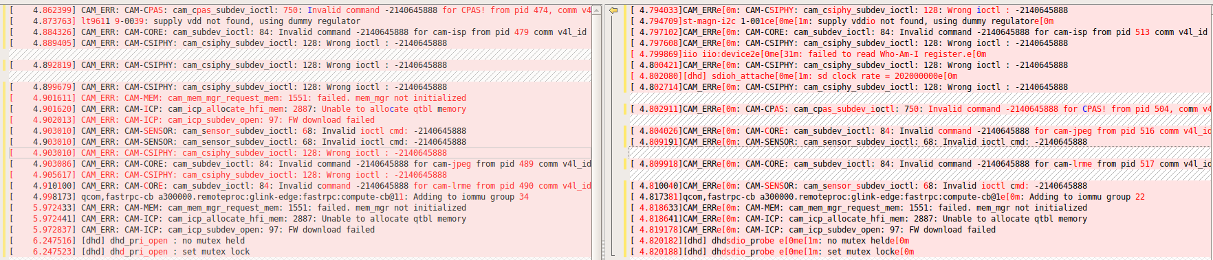

These logs are not expected to have a significant impact on the functionality of the camera. We recommend that the customer connect the camera and perform a test to verify its performance.
The official Raspberry Pi purchase link for the IMX477 module, as well as additional information, can be found in the user manual.
https://www.thundercomm.com/rubik-pi-3/en/docs/rubik-pi-3-user-manual/1.1.0/peripherals-and-interfaces/#24-csi
camera基础的初始化都是错的,后边camera内核模块都没起来,是致命影响
我们有搭环境做测试,这些log基本不会影响camera的使用,所以建议您连接camera做测试
下图中左侧为我们截取的dmesg log,右侧为您提供的dmesg log

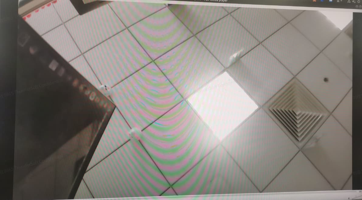

连接camera后可正常使用
好的,我找了新的fpc验证是可以的
