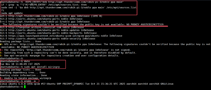

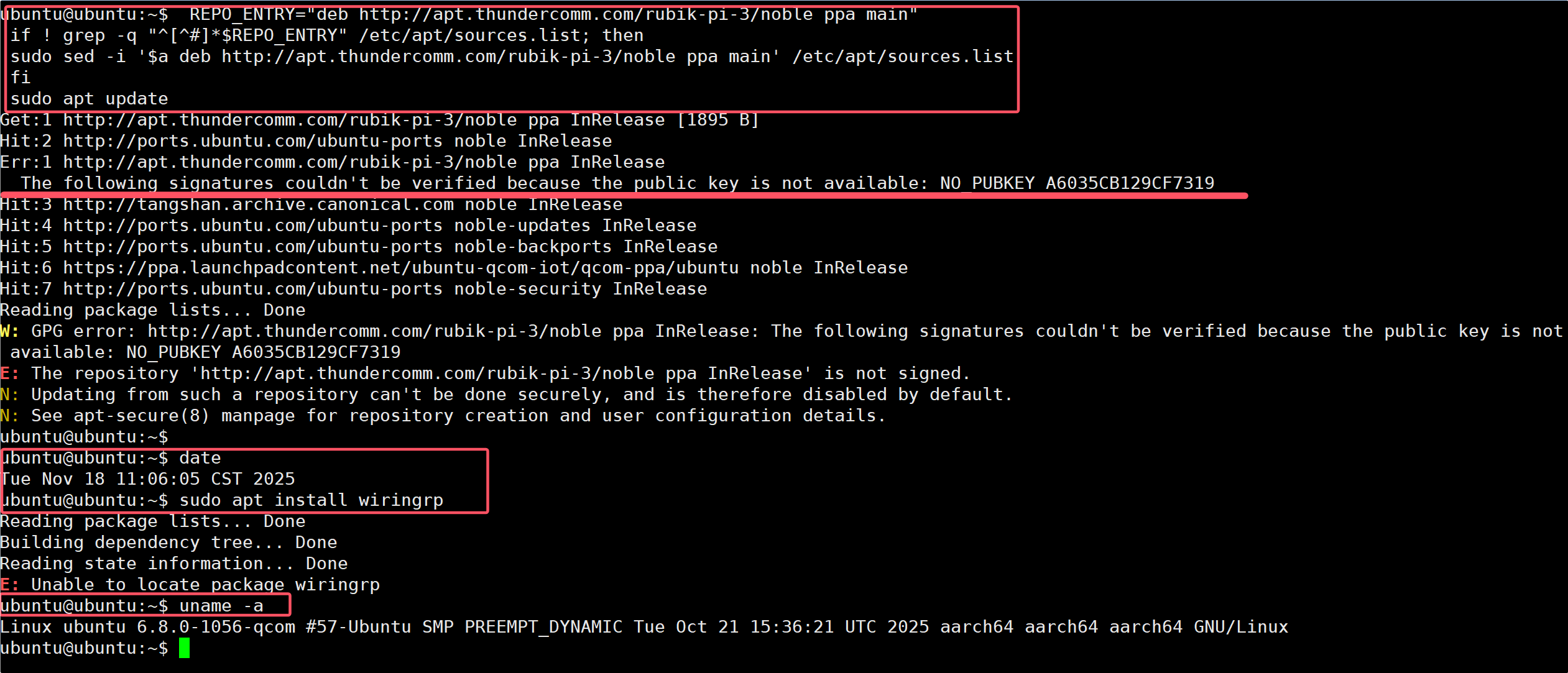

将魔方派公共个人软件档案(PPA)添加到软件源-报错
根据https://www.thundercomm.com/rubik-pi-3/cn/docs/rubik-pi-3-user-manual/1.0.0-u/peripherals-and-interfaces/1.40-pin-ls-connector#使用-gpio
软件已更新到最新,将魔方派公共个人软件档案(PPA)添加到软件源报错:签名不可用,公钥无法验证。
请使用下列命令再试一次
 REPO_ENTRY="deb http://apt.thundercomm.com/rubik-pi-3/noble ppa main"
 if ! grep -q "^[^#]*$REPO_ENTRY" /etc/apt/sources.list; then
    sudo sed -i '$a deb http://apt.thundercomm.com/rubik-pi-3/noble ppa main' /etc/apt/sources.list
 fi
sudo wget -qO - https://thundercomm.s3.dualstack.ap-northeast-1.amazonaws.com/uploads/web/rubik-pi-3/tools/key.asc | sudo tee /etc/apt/trusted.gpg.d/rubikpi3.asc
 sudo apt update
sudo apt install wiringrp
你好,使用如上命令,问题解决。wiringrp正常安装。
