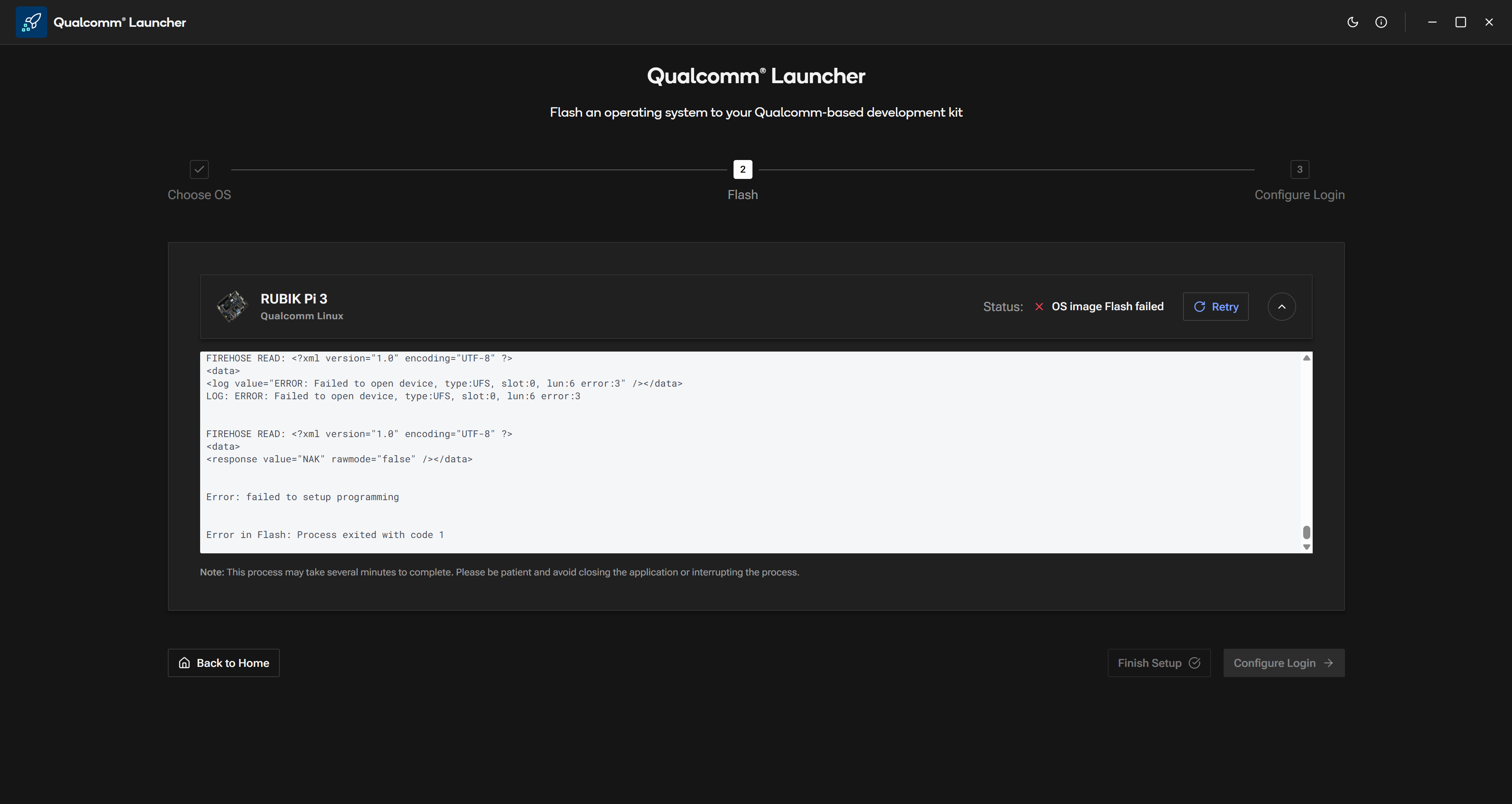

刷官方或者自己打包的linux版本会报错退出,刷不进去。
Dear Thundercomm:
1.用qualcomm launcher刷版Linux版本,会有如下报错。
{“level”:“debug”,“name”:“qualcomm-launcher”,“function”:“anonymous”,“time”:“2026-08-03T07:17:16.329Z”,“data”:[{“message”:“FIREHOSE READ: \r\n\r\n\r\nflashed “imagefv_a” successfully\r\n”}]}
{“level”:“debug”,“name”:“qualcomm-launcher”,“function”:“anonymous”,“time”:“2026-08-03T07:17:16.334Z”,“data”:[{“message”:“FIREHOSE WRITE: \r\n\r\n\r\n”}]}
{“level”:“debug”,“name”:“qualcomm-launcher”,“function”:“anonymous”,“time”:“2026-08-03T07:17:16.334Z”,“data”:[{“message”:“FIREHOSE READ: \r\n\r\n\r\nLOG: INFO: Calling handler for program\r\nFIREHOSE READ: \r\n\r\n\r\nFIREHOSE RAW BINARY WRITE: shrm.elf, 45056 bytes\r\n”}]}
{“level”:“debug”,“name”:“qualcomm-launcher”,“function”:“anonymous”,“time”:“2026-08-03T07:17:16.336Z”,“data”:[{“message”:“FIREHOSE READ: \r\n\r\n\r\nflashed “shrm_a” successfully\r\n”}]}
{“level”:“debug”,“name”:“qualcomm-launcher”,“function”:“anonymous”,“time”:“2026-08-03T07:17:16.341Z”,“data”:[{“message”:“FIREHOSE WRITE: \r\n\r\n\r\n”}]}
{“level”:“debug”,“name”:“qualcomm-launcher”,“function”:“anonymous”,“time”:“2026-08-03T07:17:16.341Z”,“data”:[{“message”:“FIREHOSE READ: \r\n\r\n\r\nLOG: INFO: Calling handler for program\r\nFIREHOSE READ: \r\n\r\n\r\nFIREHOSE RAW BINARY WRITE: multi_image.mbn, 12288 bytes\r\n”}]}
{“level”:“debug”,“name”:“qualcomm-launcher”,“function”:“anonymous”,“time”:“2026-08-03T07:17:16.342Z”,“data”:[{“message”:“FIREHOSE READ: \r\n\r\n\r\nflashed “multiimgoem_a” successfully\r\n”}]}
{“level”:“debug”,“name”:“qualcomm-launcher”,“function”:“anonymous”,“time”:“2026-08-03T07:17:16.347Z”,“data”:[{“message”:“FIREHOSE WRITE: \r\n\r\n\r\nFIREHOSE READ: \r\n\r\n\r\nLOG: INFO: Calling handler for program\r\n”}]}
{“level”:“debug”,“name”:“qualcomm-launcher”,“function”:“anonymous”,“time”:“2026-08-03T07:17:16.347Z”,“data”:[{“message”:“FIREHOSE READ: \r\n\r\n\r\nFIREHOSE RAW BINARY WRITE: cpucp.elf, 192512 bytes\r\n”}]}
{“level”:“debug”,“name”:“qualcomm-launcher”,“function”:“anonymous”,“time”:“2026-08-03T07:17:16.354Z”,“data”:[{“message”:“FIREHOSE READ: \r\n\r\n\r\nflashed “cpucp_a” successfully\r\n”}]}
{“level”:“debug”,“name”:“qualcomm-launcher”,“function”:“anonymous”,“time”:“2026-08-03T07:17:16.359Z”,“data”:[{“message”:“FIREHOSE WRITE: \r\n\r\n\r\n”}]}
{“level”:“debug”,“name”:“qualcomm-launcher”,“function”:“anonymous”,“time”:“2026-08-03T07:17:16.360Z”,“data”:[{“message”:“FIREHOSE READ: \r\n\r\n\r\nLOG: INFO: Calling handler for program\r\nFIREHOSE READ: \r\n\r\n\r\nFIREHOSE RAW BINARY WRITE: tools.fv, 393216 bytes\r\n”}]}
{“level”:“debug”,“name”:“qualcomm-launcher”,“function”:“anonymous”,“time”:“2026-08-03T07:17:16.371Z”,“data”:[{“message”:“FIREHOSE READ: \r\n\r\n\r\nflashed “toolsfv” successfully\r\n”}]}
{“level”:“debug”,“name”:“qualcomm-launcher”,“function”:“anonymous”,“time”:“2026-08-03T07:17:16.377Z”,“data”:[{“message”:“FIREHOSE WRITE: \r\n\r\n\r\n”}]}
{“level”:“debug”,“name”:“qualcomm-launcher”,“function”:“anonymous”,“time”:“2026-08-03T07:17:16.377Z”,“data”:[{“message”:“FIREHOSE READ: \r\n\r\n\r\nLOG: INFO: Calling handler for program\r\nFIREHOSE READ: \r\n\r\n\r\nFIREHOSE RAW BINARY WRITE: gpt_main4.bin, 24576 bytes\r\n”}]}
{“level”:“debug”,“name”:“qualcomm-launcher”,“function”:“anonymous”,“time”:“2026-08-03T07:17:16.379Z”,“data”:[{“message”:“FIREHOSE READ: \r\n\r\n\r\nflashed “PrimaryGPT” successfully\r\n”}]}
{“level”:“debug”,“name”:“qualcomm-launcher”,“function”:“anonymous”,“time”:“2026-08-03T07:17:16.384Z”,“data”:[{“message”:“FIREHOSE WRITE: \r\n\r\n\r\nFIREHOSE READ: \r\n\r\n\r\n”}]}
{“level”:“debug”,“name”:“qualcomm-launcher”,“function”:“anonymous”,“time”:“2026-08-03T07:17:16.384Z”,“data”:[{“message”:“LOG: INFO: Calling handler for program\r\nFIREHOSE READ: \r\n\r\n\r\nFIREHOSE RAW BINARY WRITE: gpt_backup4.bin, 20480 bytes\r\n”}]}
{“level”:“debug”,“name”:“qualcomm-launcher”,“function”:“anonymous”,“time”:“2026-08-03T07:17:16.385Z”,“data”:[{“message”:“FIREHOSE READ: \r\n\r\n\r\nflashed “BackupGPT” successfully\r\n”}]}
{“level”:“debug”,“name”:“qualcomm-launcher”,“function”:“anonymous”,“time”:“2026-08-03T07:17:16.390Z”,“data”:[{“message”:“FIREHOSE WRITE: \r\n\r\n\r\n”}]}
{“level”:“debug”,“name”:“qualcomm-launcher”,“function”:“anonymous”,“time”:“2026-08-03T07:17:16.390Z”,“data”:[{“message”:“FIREHOSE READ: \r\n\r\n\r\nLOG: INFO: Calling handler for program\r\nFIREHOSE READ: \r\n\r\n\r\n”}]}
{“level”:“debug”,“name”:“qualcomm-launcher”,“function”:“anonymous”,“time”:“2026-08-03T07:17:16.390Z”,“data”:[{“message”:“FIREHOSE RAW BINARY WRITE: gpt_main5.bin, 24576 bytes\r\n”}]}
{“level”:“debug”,“name”:“qualcomm-launcher”,“function”:“anonymous”,“time”:“2026-08-03T07:17:16.392Z”,“data”:[{“message”:“FIREHOSE READ: \r\n\r\n\r\nflashed “PrimaryGPT” successfully\r\n”}]}
{“level”:“debug”,“name”:“qualcomm-launcher”,“function”:“anonymous”,“time”:“2026-08-03T07:17:16.399Z”,“data”:[{“message”:“FIREHOSE WRITE: \r\n\r\n\r\n”}]}
{“level”:“debug”,“name”:“qualcomm-launcher”,“function”:“anonymous”,“time”:“2026-08-03T07:17:16.399Z”,“data”:[{“message”:“FIREHOSE READ: \r\n\r\n\r\nLOG: INFO: Calling handler for program\r\nFIREHOSE READ: \r\n\r\n\r\nFIREHOSE RAW BINARY WRITE: gpt_backup5.bin, 20480 bytes\r\n”}]}
{“level”:“debug”,“name”:“qualcomm-launcher”,“function”:“anonymous”,“time”:“2026-08-03T07:17:16.400Z”,“data”:[{“message”:“FIREHOSE READ: \r\n\r\n\r\nflashed “BackupGPT” successfully\r\n”}]}
{“level”:“debug”,“name”:“qualcomm-launcher”,“function”:“anonymous”,“time”:“2026-08-03T07:17:16.407Z”,“data”:[{“message”:“FIREHOSE WRITE: \r\n\r\n\r\n”}]}
{“level”:“debug”,“name”:“qualcomm-launcher”,“function”:“anonymous”,“time”:“2026-08-03T07:17:16.407Z”,“data”:[{“message”:“FIREHOSE READ: \r\n\r\n\r\nLOG: INFO: Calling handler for program\r\nFIREHOSE READ: \r\n\r\n\r\nLOG: ERROR: Failed to open the UFS Device slot 0 partition 6\r\nFIREHOSE READ: \r\n\r\n\r\nLOG: ERROR: Failed to open the device:3 slot:0 partition:6 error:0\r\n”}]}
{“level”:“debug”,“name”:“qualcomm-launcher”,“function”:“anonymous”,“time”:“2026-08-03T07:17:16.407Z”,“data”:[{“message”:“FIREHOSE READ: \r\n\r\n\r\nLOG: ERROR: OPEN handle NULL and no error, weird 344640964\r\nFIREHOSE READ: \r\n\r\n\r\nLOG: ERROR: Failed to open device, type:UFS, slot:0, lun:6 error:3\r\n”}]}
{“level”:“debug”,“name”:“qualcomm-launcher”,“function”:“anonymous”,“time”:“2026-08-03T07:17:16.407Z”,“data”:[{“message”:“FIREHOSE READ: \r\n\r\n\r\n”}]}
{“level”:“debug”,“name”:“qualcomm-launcher”,“function”:“anonymous”,“time”:“2026-08-03T07:17:16.408Z”,“data”:[{“message”:“Error: failed to setup programming\r\n”}]}
{“level”:“debug”,“name”:“qualcomm-launcher”,“function”:“anonymous”,“time”:“2026-08-03T07:17:16.416Z”,“data”:[{“message”:“Error in Flash: Process exited with code 1”}]}
{“level”:“debug”,“name”:“qualcomm-launcher”,“function”:“anonymous”,“time”:“2026-08-03T07:17:16.416Z”,“data”:[{“message”:“OS Image”},{“message”:“Flash”},{“message”:“failed”}]}
{“level”:“debug”,“name”:“qualcomm-launcher”,“function”:“anonymous”,“time”:“2026-08-03T07:17:21.377Z”,“data”:[{“message”:“Received IPC message:”},{“message”:“get-connected-devices”}]

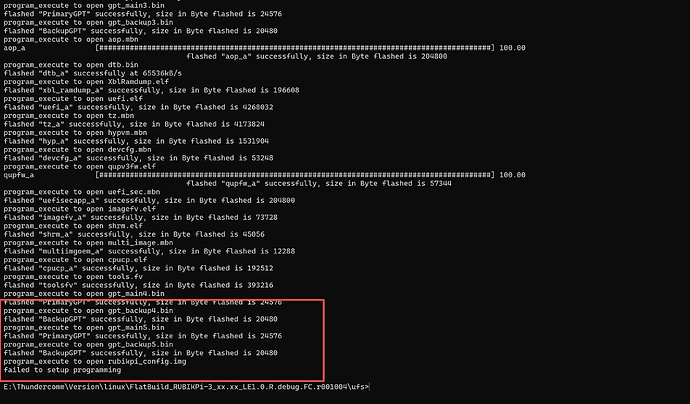

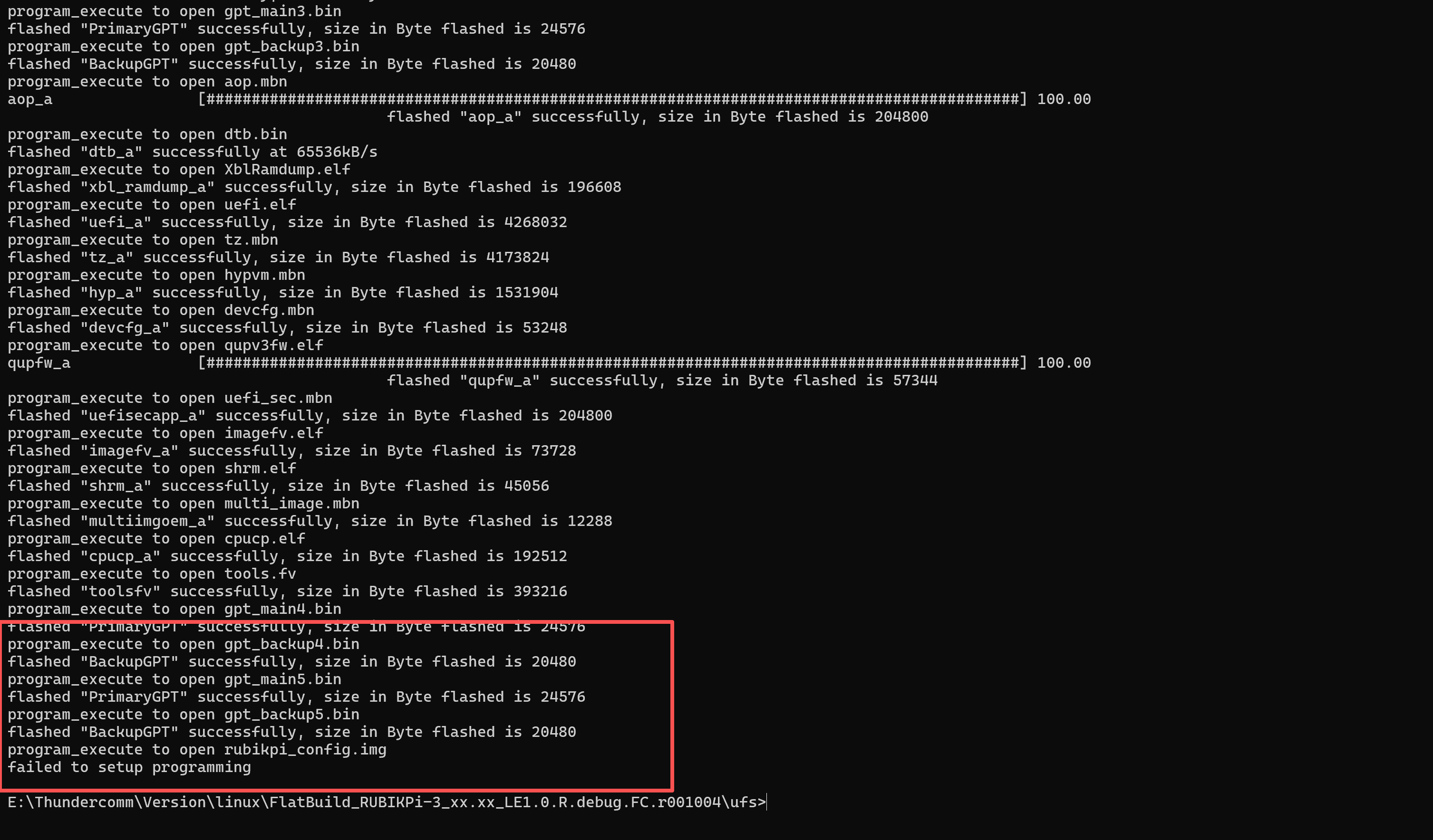

请根据官网指引,尝试使用QDL进行烧录。
我下载的镜像版本是Linux 1.2 用QDL下载的时候,会有如下报错。
版本解压出来应该没问题,没刷完整是啥原因,有啥解决办法不。

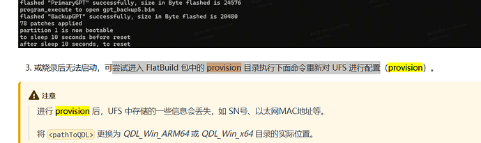

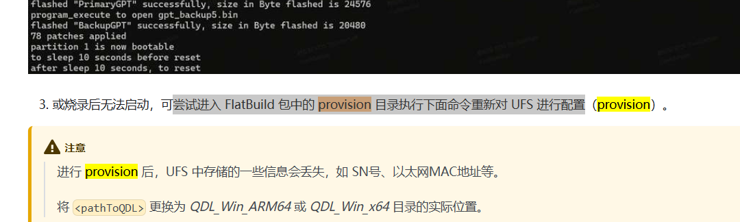

快速开始 | 魔方派文档中心
请查看文档中尝试进入 FlatBuild 包中的 provision 目录执行下面命令重新对 UFS 进行配置
